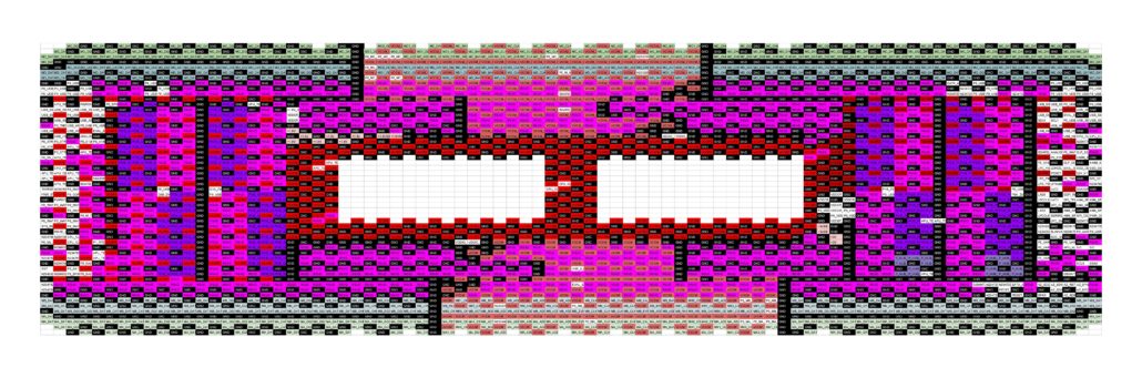

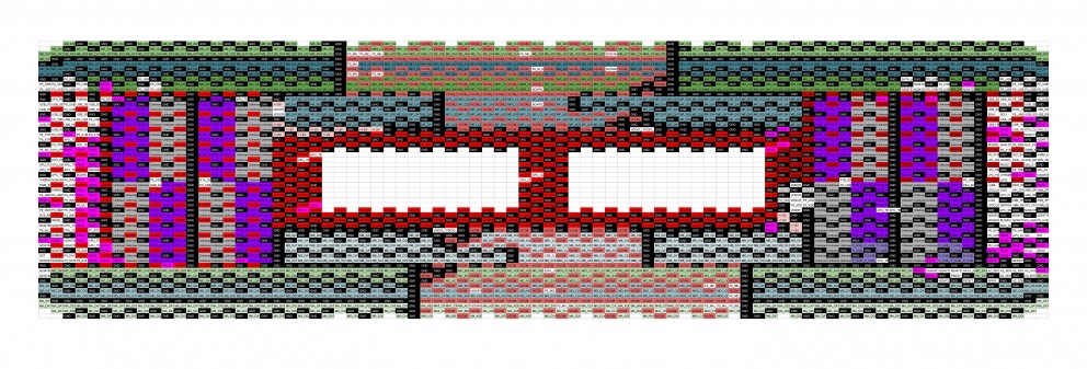

I know Threadripper 3 needs more power, but I don't see why the socket could not be backward compatible.
On sTRX4, lots of pins that were previously unused by the TR4 socket have been enabled. The pin count is still 4094 for the socket itself for the SP3 socket but the revised naming should be considered here. The sTRX4 SP3 socket has more pins enabled than the TR4 SP3 socket.
TR4 SP3 Socket
e16245d15247cb0b975b0881f88ce1a6_1573563
sTRX4 SP3 Socket
Almost all pins are the same, except that some pins and two i/o data pins with unknown features remain surplus in TR4.
TR4 SP3 Socket
sTRX4 SP3 Socket
Could it be actually backwards compatible, just not enabled?
processors on both sides are incompatible because AMD has prevented them from booting through ID pin recognition.
In other words, if backward compatibility and scaling are needed, AMD will just put a ticket like TR4v2 and use surplus pins to make it closer to SP3.
