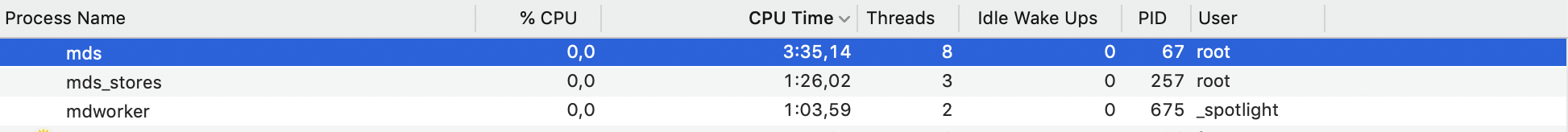

I ran Etrecheck and after a long time it said "A process is using a large percentage of your CPU." The process was mentioned in the report as "Other processes 116.57 % (?) Activity monitor showed a very high CPU time for meta data server related processes. But there weren't any processes using a high amount of CPU at the time of checking.

Then I used Disk Utility in Recovery Modus but the drive was ok. Back in MacOS everything was still going very slow. Than suddenly the internet connection came back and all the problems were gone! This was great, but my iMac should function normally when there is no internet. So I unplugged the router, restarted, but everything was still working great. Then I did a Apple Diagnostic test and all Hardware was functioning ok.
