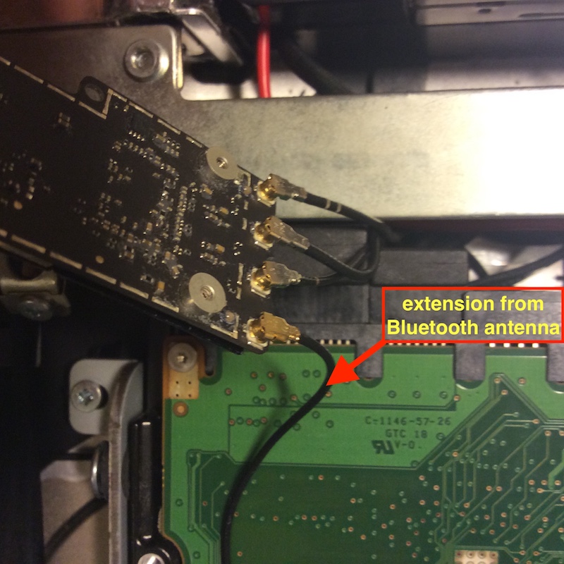

I finished the install, but there are some unresolved issues. It works (sort of), but not as well as I would have liked.
First off, all of the parts I received from OSXWIFI are installed and both BT 4.0 and WiFi functions are correctly listed in system report. I also have a 2013 27 inch iMac so I can compare functions I am seeing with a known good and working system. It uses the same WiFi/BT combo card. The new WiFi/BT card seated in the miniPCI-E adapter is a little bit thicker than the old WiFi card and presses up against the back of the LCD screen, but it does not appear to create any problems. The screw holes on the new adapter and the old WiFi card are on opposite sides so I had to secure the new card with a couple of small pieces of duct tape (hey, it works!).
I can confirm that the miniPCI-E does NOT have the USB D+/D- signals. I was hoping that it did as it would make things much easier. I had to use the kit's USB cables and route them through the RAM compartment and around to the back of the iMac to one of the external USB ports. I am not happy with this arrangement, but until I figure something else out I'm stuck with it. It was not clear what type of connection the old BT card had. It had 5 wires, but the colors did not correspond to standard USB pin out configuration. I simply unplugged it and taped the connector to the inside of the case.
One last obstacle was needing a wired keyboard and mouse since the BT ones will obviously not be paired with the new BT card. If you need to enter recovery mode, it will have to be an Apple wired keyboard.

Hey brother. Just curious (knowing this is an old thread)... could you elaborate on where you plugged in the USB cable? I've got everything else squared away (had to use electrical tape as well). Thanks!

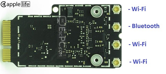

I have a Mid 2011 21.5 iMad (A1311 EMC 2428).
I installed a BCM94331CD which is a lot cheaper than the BCM94360CD. The whole upgrade costed less than $20.
I carry my iMac between two places and I am experiencing issues with the bluetooth only at one of them.
Maybe there is something that is interfering with the bluetooth. The movement of the mouse cursor is not smooth and lately it became almost unusable.
I was suspicious about the u.fl extension I used and I tried to connect one of the wifi antennas on the card's Bluetooth connector. The RSSI of the magic mouse was about -75dBm and now it is -45dBm. It's working flawlessly. I don't remember what the RSSI and noise values of the wifi were, but now they are: RSSI:-45dBm and noise:-80dBm.
The wifi needs 3 cables and the bluetooth needs one. I can see two antennas above the screen (one for wifi and one for bluetooth) and one antenna on the lower left of the screen. Where does the 3rd antenna cable come from? Will I have any issues after connecting the bluetooth antenna on the wifi connector and vise versa? Should I worry?
This is the card I got:
and this is how I installed it:

... Will I have any issues after connecting the Bluetooth antenna on the wifi connector and vise versa? Should I worry? ...
That's a good question. I have a similar issue regarding the antenna config at an Apple Broadcom BCM94360CSAX 802.11ac & BT 4.0 combo card.
Physically theses antennas are quite equal, - the effective reason to make a difference lies in the LENGTH of the corresponding cable. That's the reason why the Bluetooth antenna should be always connected to the "J2" connector, - because the Bluetooth antenna is usually the "shortest" one.
My question is now if that "rule" corresponds to all Apple Broadcom Bluetooth 4.x capable cards? So the BCM94360CD, BCM94360CSAX, BCM943602CS, and so on...
Well, it seems that this is not the sole and only "truth". A 802.11ac & BT 4.0 upgraded 2007 (!!!) iMac seems to work also with a different antenna config. ;)
https://de.ifixit.com/Answers/View/162178/Wireless+Airport+Card+Replacement+with+New+802.11ac#answer359150
Update 22.12.2016
I have now tested the suggested antenna config at a BCM94360CSAX card with Bluetooth on socket "J2". I am surprised, - it seems that this config works really somewhat better.
