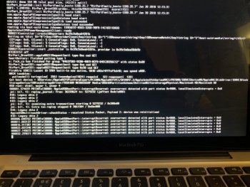

I am trying to help fix a friends Mackbook A1278. It turns on, chimes and then the Apple Logo appears and then the progress bar appears and slowly, very slowly moves to about 80% and just stays there.
I tried restting VRAM and SMC and then tried Safe Mode, no joy, Recovery Mode does not work, Internet Recovery Mode will not show up my SSID to connect to.
I then tried CMD +V to start in verbose mode to see the output, its seems that the boot stalls with the following warning being repeated:
000032.259671 PRT3@fa130000: AppleUSBHostPort::interruptOccured: overcurrent detected with port status 0x4000, localSimulatedInterrupts =0x0
I only found a couple of references to this on the internet, relating to a damaged USB port requiring a Logic Board replacement?
