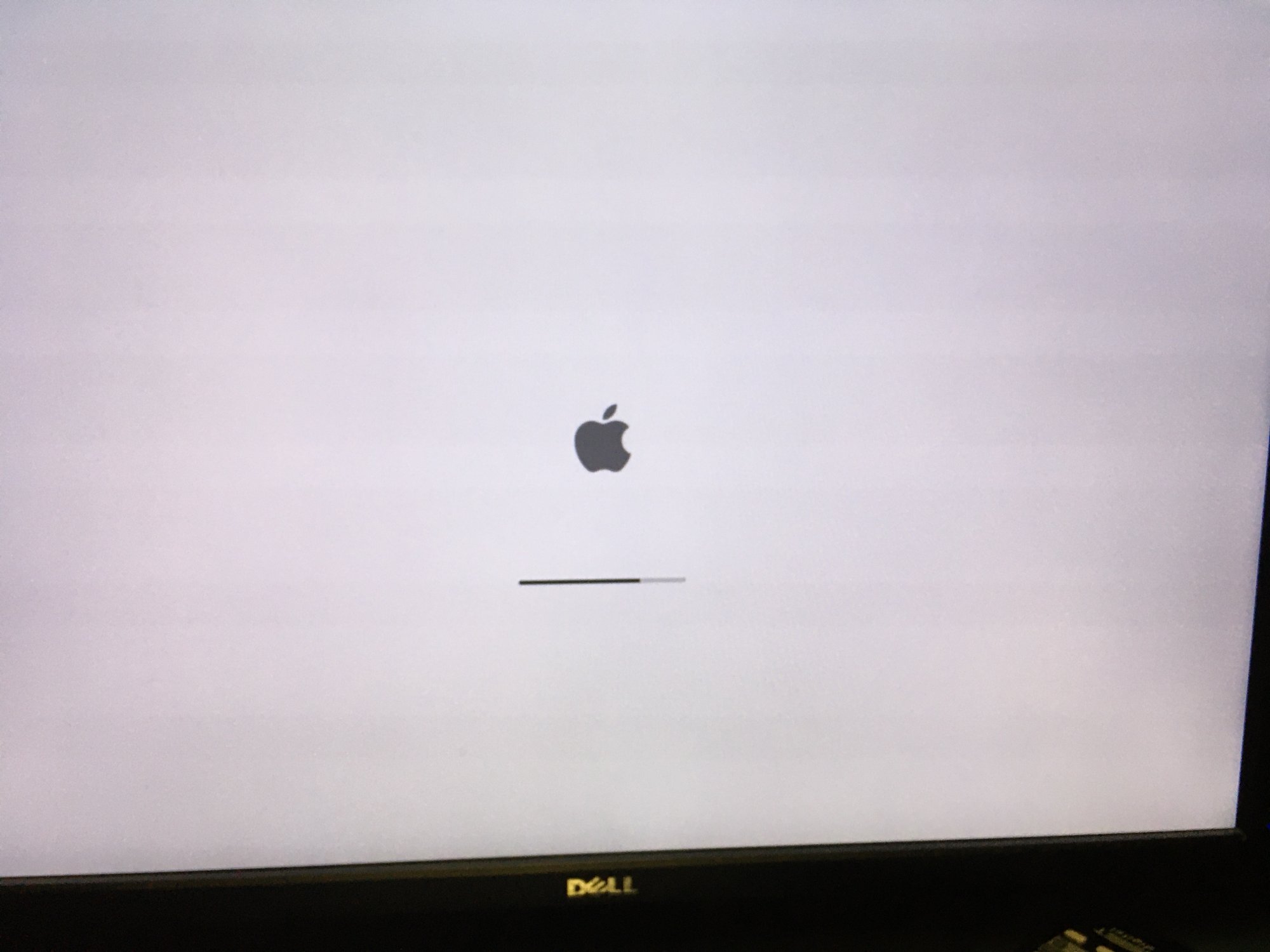

Hi Guys!
At May I’ve made the transition to Mojave 10.14.4 without any problem! (MacPro 8 cores 5.1, Nvidea QUADRO K5000 for Mac, 32 GB RAM, Samsung 860 EVO. Firmware 141.0.0.0.0)
15 days ago I realized that although I had already updated to Mojave 10.14.6 I had not made the firmware update to 144.0.0.0.0 ...
I downloaded the full 10.14.6 and did with no problem just the firmware update to 144.0.0.0!
Everything was working normally until yesterday my MacPro freeze in 2/3 of boot status bar...
I did a SMC and PRAM RESET, removed all cables except the keyboard and mouse but nothing changed ...
I tried a boot from the flash drive but the same thing happened ... the boot stops at 2/3 of the status bar ...
Doesn't seem like a software or HD problem
I’m suspicious that's maybe one video card problem... Did the firmware update damage my NVIDEA K5000 video card?
Have you seen this problem before?

Hi Guys!
There are no chances of the Mac Pro EfiFlasher to interfere in any way with a GPU.
The firmware flasher always test if the GPU is METAL compatible, Mojave requires it, but it’s the only thing.
Nothing on the GPU is updated or changed. I don’t doubt that you have a problem, but it’s not firmware flasher related.
