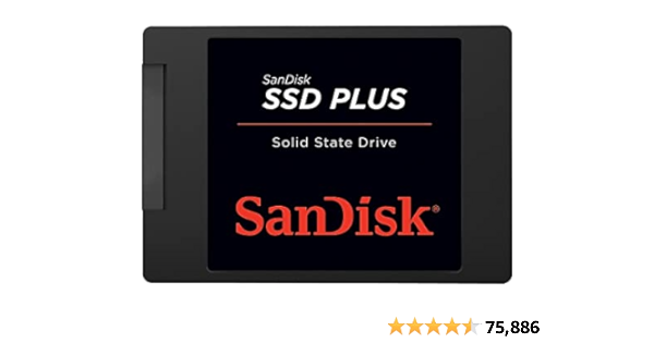

I don't like OWC anymore. 10 or 15 years ago they were great. Now they sell sub standard parts.
I just bought a brand new lighting cable for my 12.9 iPad Pro a few days ago . I lost the other one. Cable when hooked up says iPad is not charging. cheap inferior cable made in China.
I use Sandisk SSD's in my Mac mini's 2012 i7's. They have the best read and write times. and they last.
