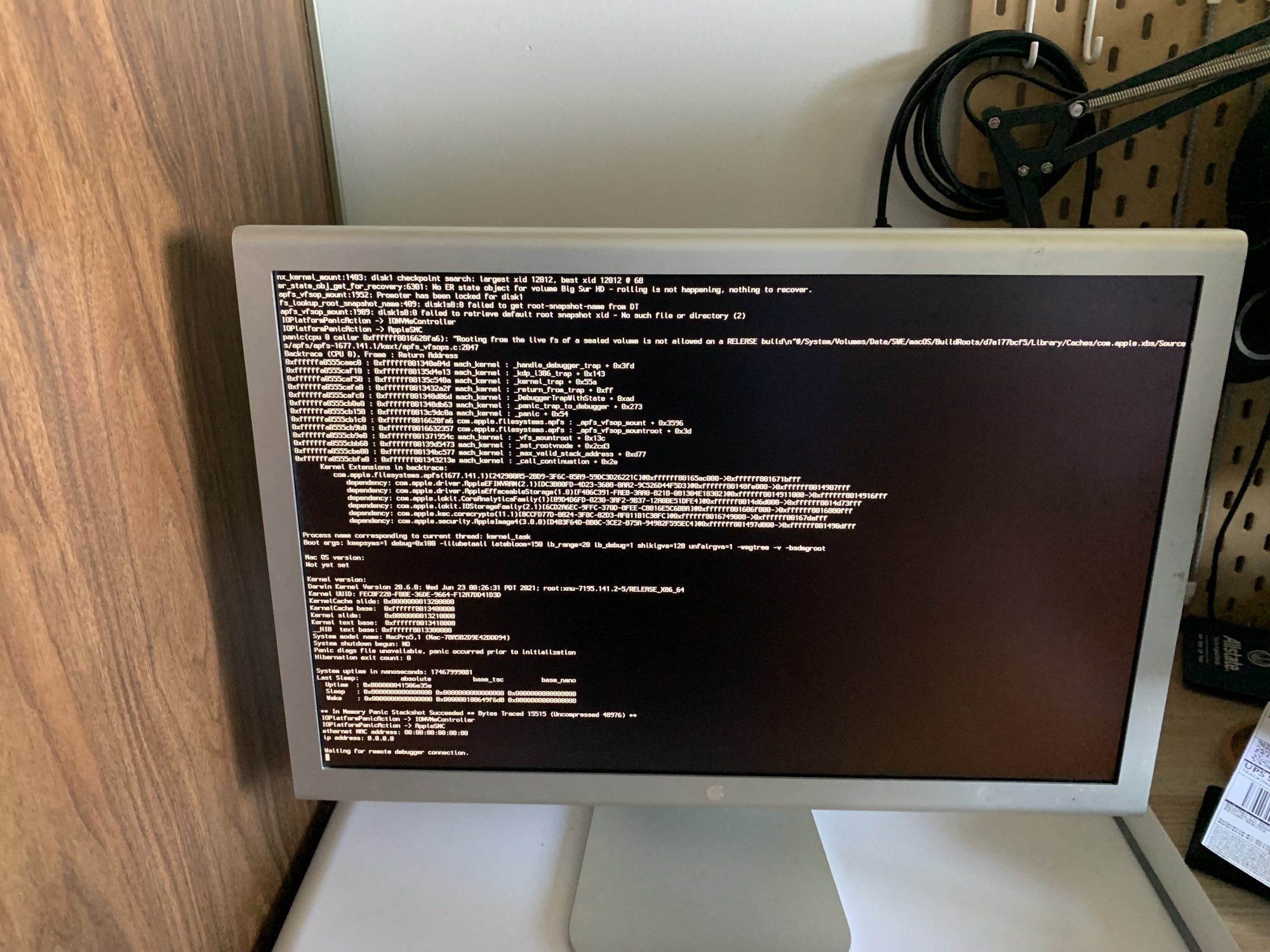

  • Booting macOS would fail on cryptography verification relating to the APFS seal
    • This would report on every SSD I installed, including those that boot fine in other machines

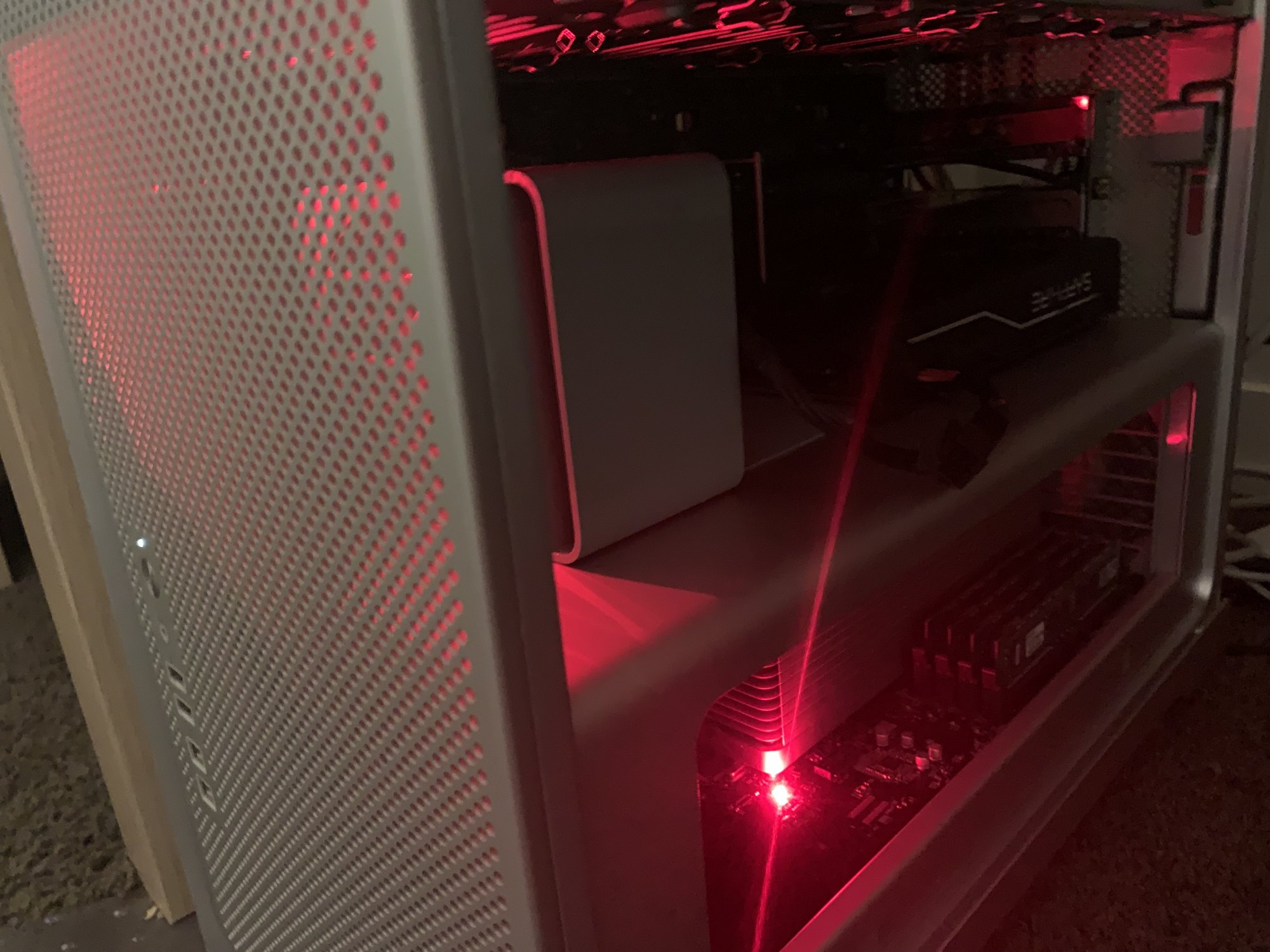

And finally, the CPU tray lit up reporting "CPU Missing or Overheating", thus resulting in a non-bootable machine. This was quite frustrating as I only had the machine for a week, but the Mac Pro was a tool for OpenCore development and not my daily driver. So I was ready to throw in the towel and put the machine on a shelf to mess with another day.
Cryptography errorsCPU Tray light

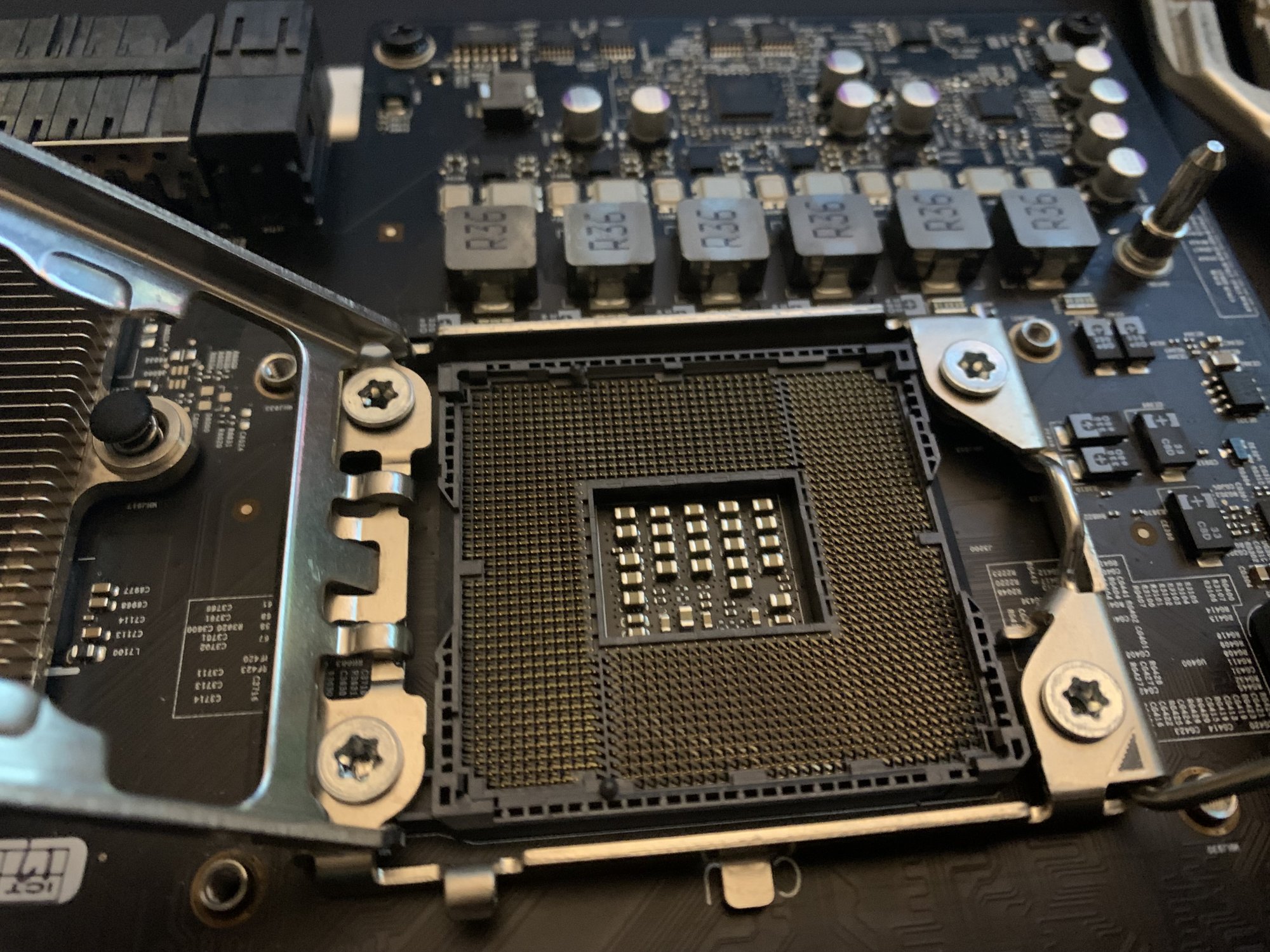

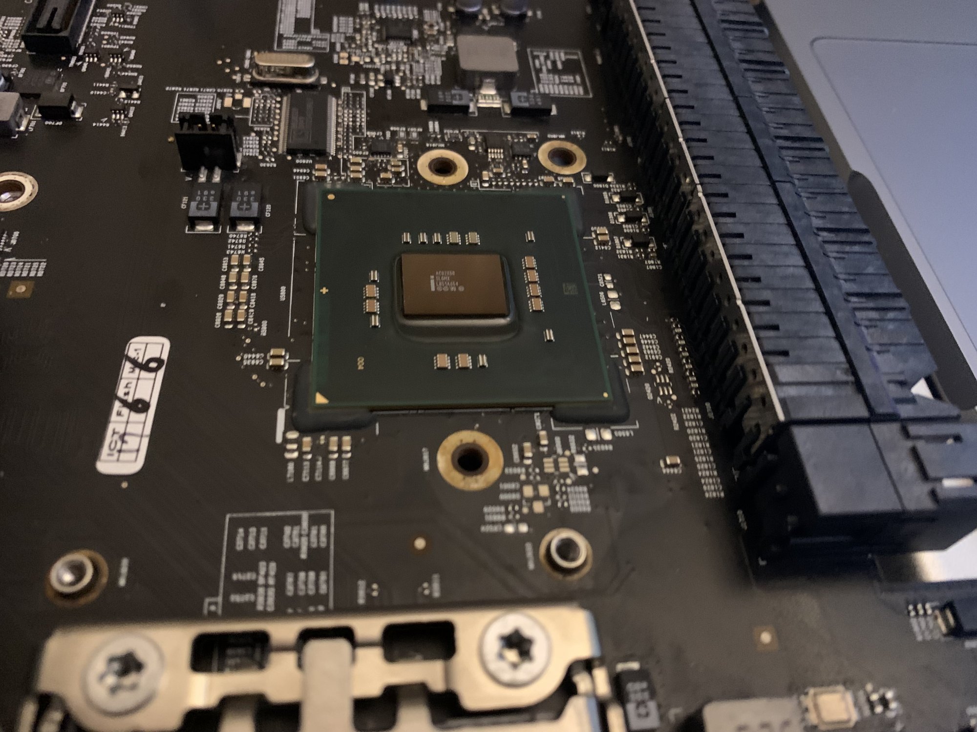

I assumed that the CPU itself was dead due to the weird crypto errors, so was going to wait till the new CPU arrived. I then did a lot more cleaning, looking at the socket for issues but to no avail. However, after a bit of discussion with a user on my Discord server, ylluminate, they mentioned an issue with the CPU Tray/Northbridge on one of their 4,1 (flashed 5,1) systems. They opted to replace the whole tray at the time due to time reasons but this gave me an idea, what if the Northbridge has too much one-sided pressure on it from the broken heatsink?
CPU Socket intackNorthBridge

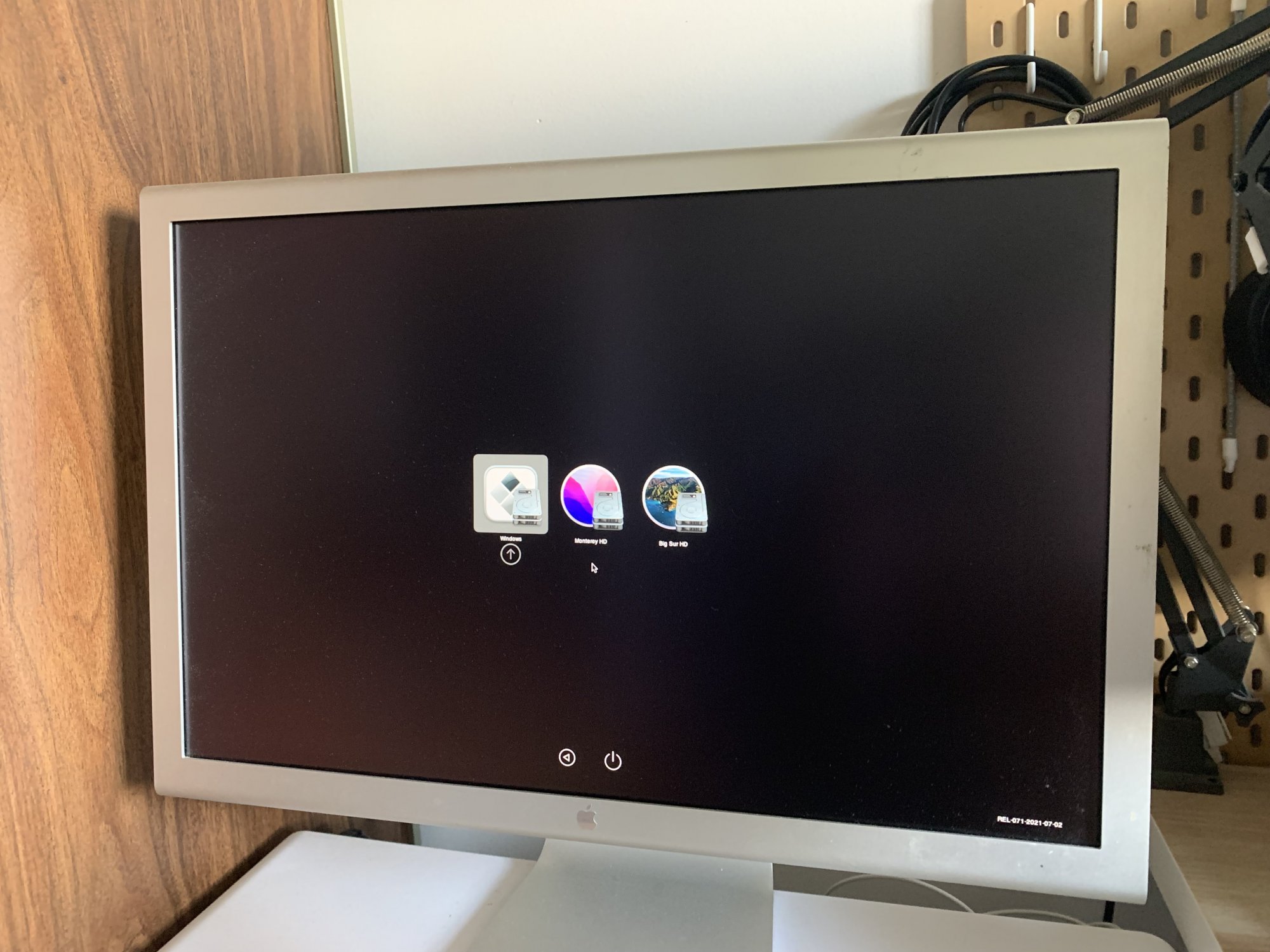

I followed this up by first removing the chipset heatsink and booting as is. And wouldn't you know, the thing booted! I later threw some zip ties on the heatsink and an abundance of thermal paste to aid with the thermal transfer, as I was afraid any pressure would cause the issues to pop up again.

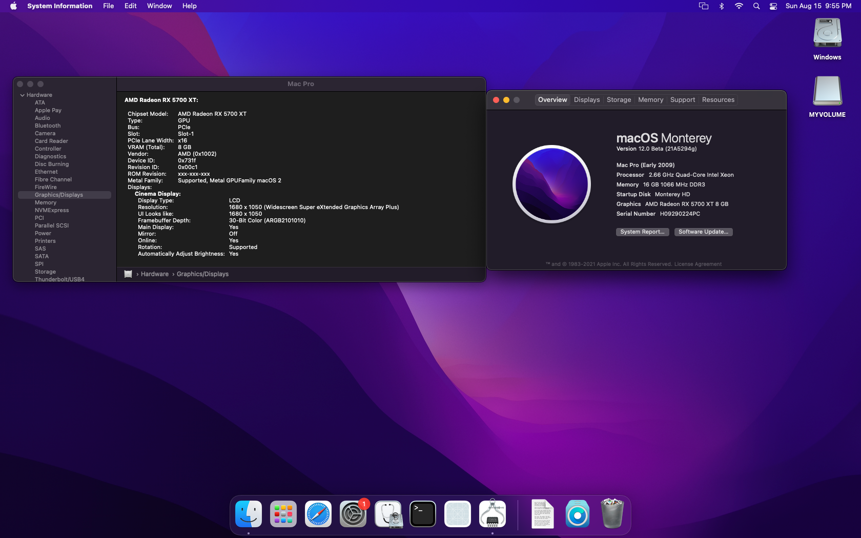

OpenCore Boot Picker LoadedmacOS loaded

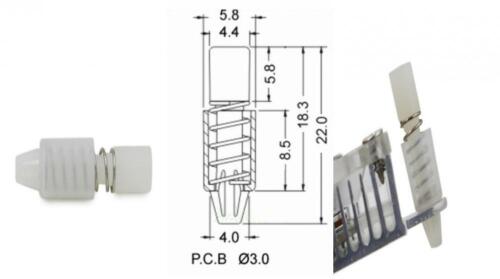

The problem with the broken MacPro Northbridge heat sink retainers is a common problem that occurs as the plastic retainers age. It is the cause of many odd MacPro behaviors. YouTube shows several methods of replacing the retainers with posts, screws with insulation and replacement plastic retainers which can be found on ebay. The important thing is to put in a permanent replacement for the retainers (always replace both) which will assure proper Northbridge temperature. Check to see that the North bridge temperature is in the correct range after the repair and a few days after the heatsink compound has been compressed.

If you still have both original springs you could mount the heatsink with 2 (metal or nylon) screws M3x16mm , nuts and washers .
This is a very effective and permanent solution for the NB rivets issue.
The Delta NB heatsink- diode after a correct repaste should be 12 degrees Celsius or less.

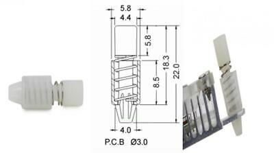

I was worried about this previously so I took the CPU tray out, cut off the plastic retaining pins and took that Northbridge off and re-did the thermal grease (Arctic Silver 5 now) and secured it again with new plastic pins (the little white ones off ebay):
One of the Youtube videos mentioned these had to be shorted a little to fit, that's what I did. Everything seems to be running okay now.
