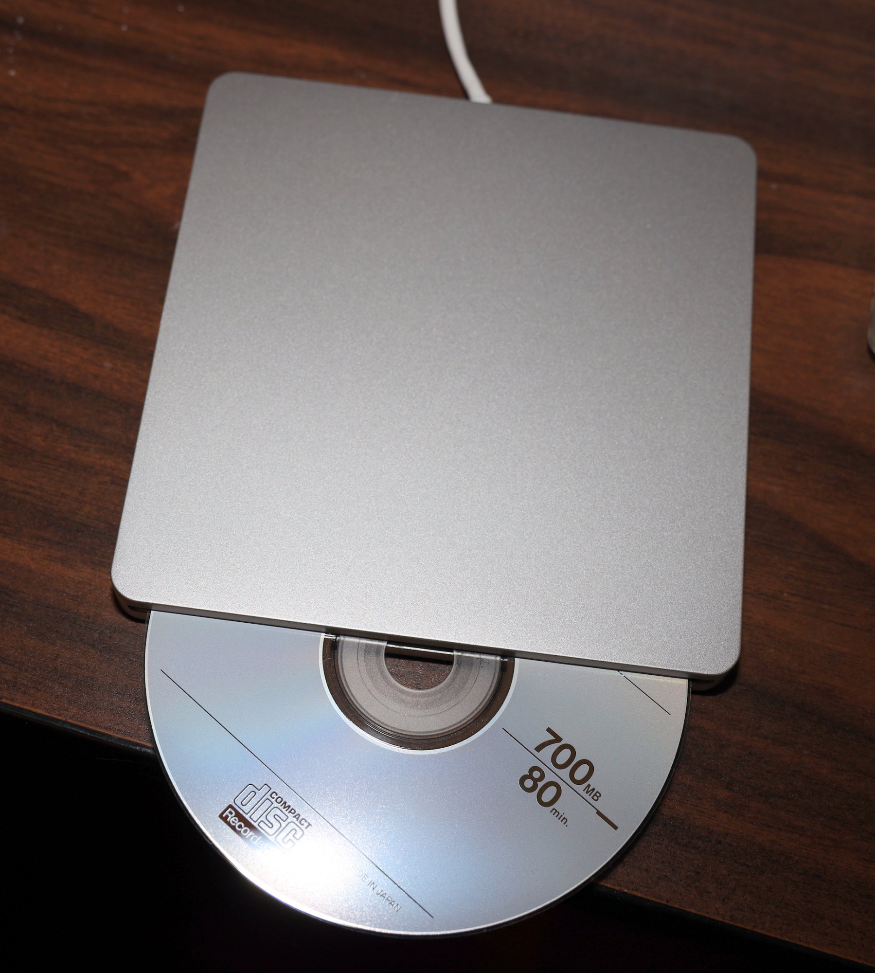

A friend disassembled an old MacBook Pro he no longer used, and gave me the optical drive from inside it. I bought an enclosure on ebay ($20, just wanted to see if I could revive it), and it came out like this:
