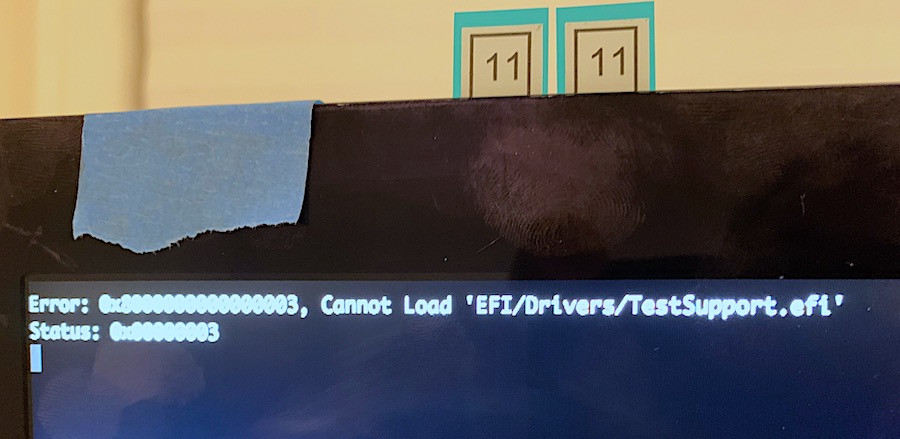

I just installed new blade and SSD drive, having fan issues (made a post about it). I just want to run the hardware test on the machine.
I shut down the iMac, turn on the iMac while pressing key "D", and spinning globe comes up on the white page, then this error pops up.

I have the same problem with the same model iMac. I added two more 8 GB memory cards a few weeks ago. Soon after, the computer began crashing after about ½ hour. Is there an alternative to Apple Hardware Diagnostics?

The network/internet diagnostics don't work on some older Macs. I have read that some firmware update inadvertently removed that online testing capability.
You CAN download the hardware test app for your Mac (2012 iMac, 27-inch would be the iMac13,2. It's in the list for download here - https://github.com/upekkha/AppleHardwareTest
