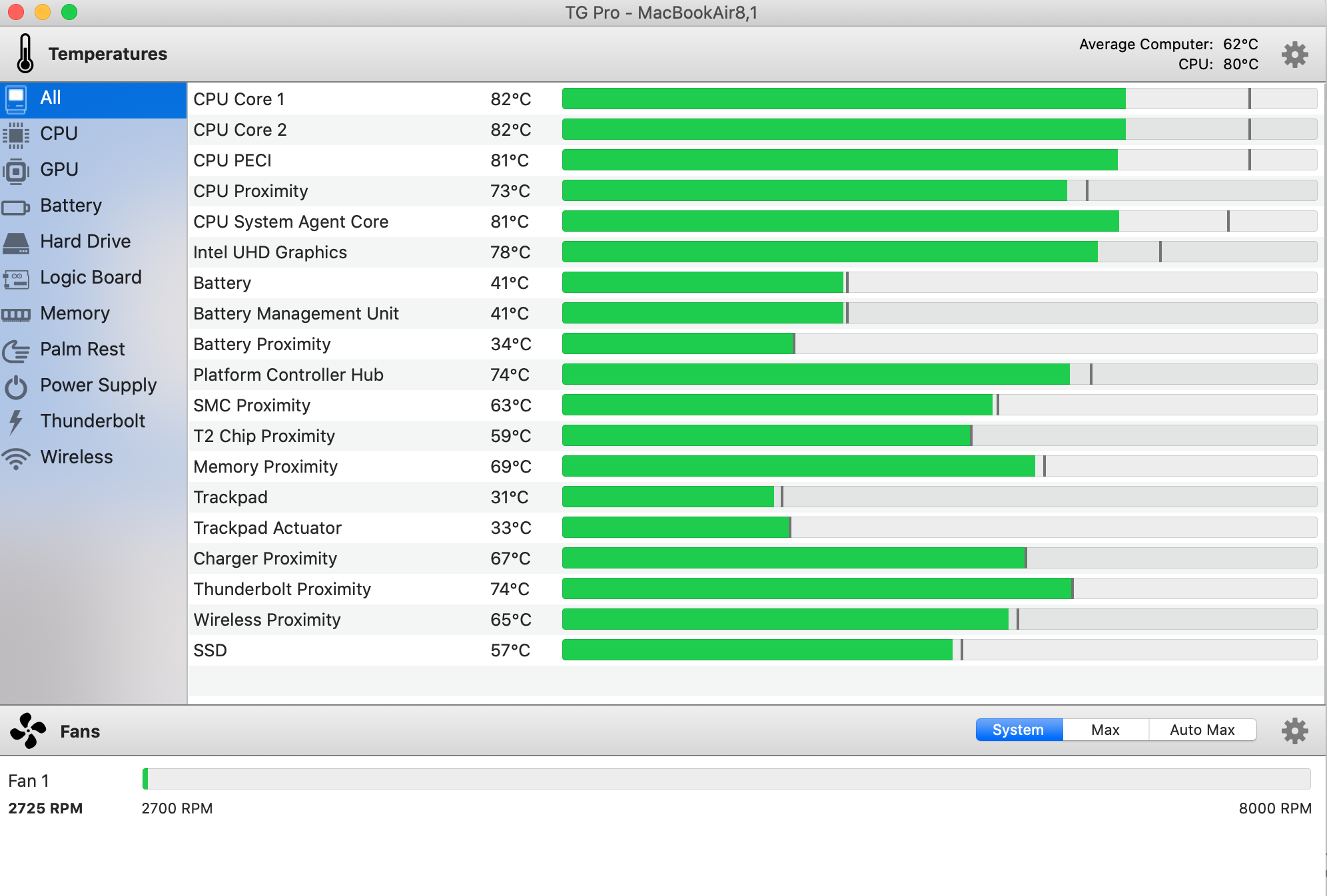

Try installing TG Pro to get more info on temperatures & fan activity (https://www.tunabellysoftware.com/tgpro/)
Install the app, then post a screengrab here which will help people to diagnose your issue. If the temps are as hot as you suggest, that isn't normal and people will then be able to advise on what to do.

Thanks, here's the screenshot

I'll test and post results....
[automerge]1589999210[/automerge]
Correction: Its fluctuating between 70-90ish when I am using it - 60C when it's idle.
