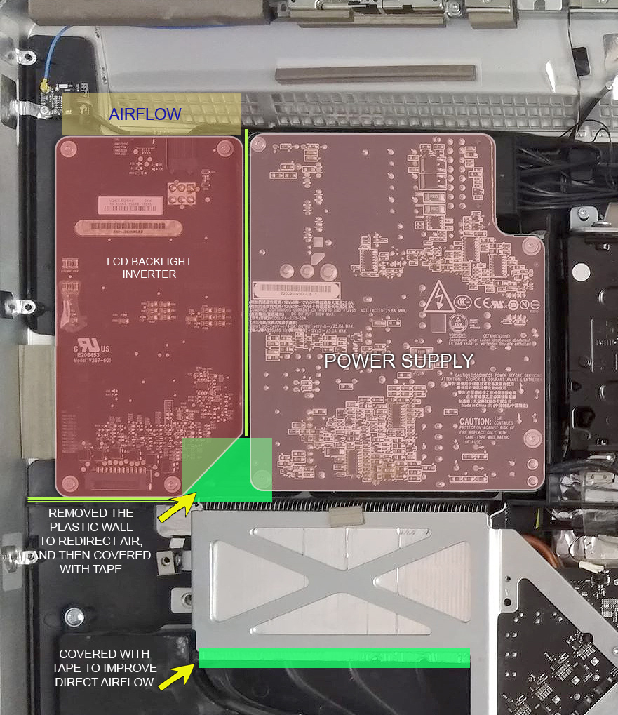

OK, your GPU and motherboard use 2 wires to send signals to the LCD backlight driver, one is for backlight on/off, and the other for PWM brightness control. These are in fact identified on the PCB of the backlight driver (top left of your early iMac). Check it out and you will confirm this info. Also, the pins of the wiring are also identified if you look carefully.
There are multiple ways to produce this signal, the SP32 is one and the explanation provided is super helpful. You will need an oscilloscope to confirm your values, or an advanced multimeter able to measure 10-20Khz frequencies and duty cycles. Don't worry, this doesn't have to be perfect 13khz, you can get away with 13.05 / 13.10 etc. The article also mentions this can be done using the dyinglight module created by dosdude1.The brightness control is managed via a 13Khz signal cable, without this signal the screen goes off. And the level of brightness is specified via the duty cycle on the signal (shorter = less brightness, longer = more bright). Then the author describes how to produce this signal using an SP32 board (it's like an Arduino). Keep in mind the voltage of the signal, it's 3.25v. If you don't adjust the peak voltage you might fry your board.

Important: the Arduino Uno produces 5v peak voltage signals on the output pins, so you have to use a voltage divider (with 2 resistors) to lower this value. The Arduino Nano is even a better option, as it's already produces 3.25v output signals.
Just like these guys suggest, you can get the energy from diff areas of the board (be it 5v or 12v) to power your Arduino Uno (or whatever board you want to use). My guess is... if you live in the US or any similar country, you can easily get the parts mentioned on the Medium article faster than me, so most likely you won't be interested on the Arduino Uno solution. Long story short, I decided to wire and power the Arduino directly to an USB port, this way I can update the code whenever I need to without opening the iMac, that's jut me.So yes, I now have full brightness control on this old 2009 Corei5 iMac, besides I enjoy 2G of video memory, it's a very fast GPU. Also, the machine runs REALLY cool, no overheating whatsoever. There is still no USB booting, but that's no problem, and the 1T hard drive has Ventoy with multiple operative systems, and the optical drive was replaced by a fast SSD.

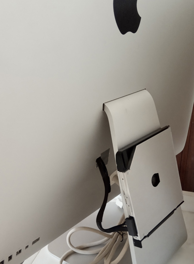

I really HATED opening this iMac over and over, so, I made a modification moving the HDD caddy (with the SSD) to the back stand via a simple hole on the case, now I can access the drive anytime, fast and easily, even replace it as if it was a diskette.
