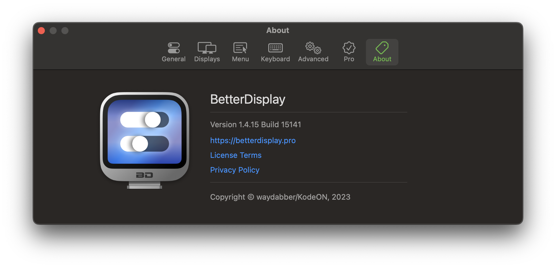

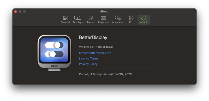

I use BetterDisplay for that... I have an LG 32" monitor, but should work.
Reactions: theorist9
Thanks for the suggestion.
BetterDisplay says: "External display hardware backlight control and volume control require DDC capable, natively connected display or an Apple display. " I checked my Dell displays, and both have DDC enabled. However, Dell's website says:
"Dell monitors support DDC/CI on VGA, DVI, DP and HDMI inputs. DDC/CI is not supported on USB connection."
I wonder if that means they are not DDC capable over Thunderbolt. I'll have to try it out to see.
