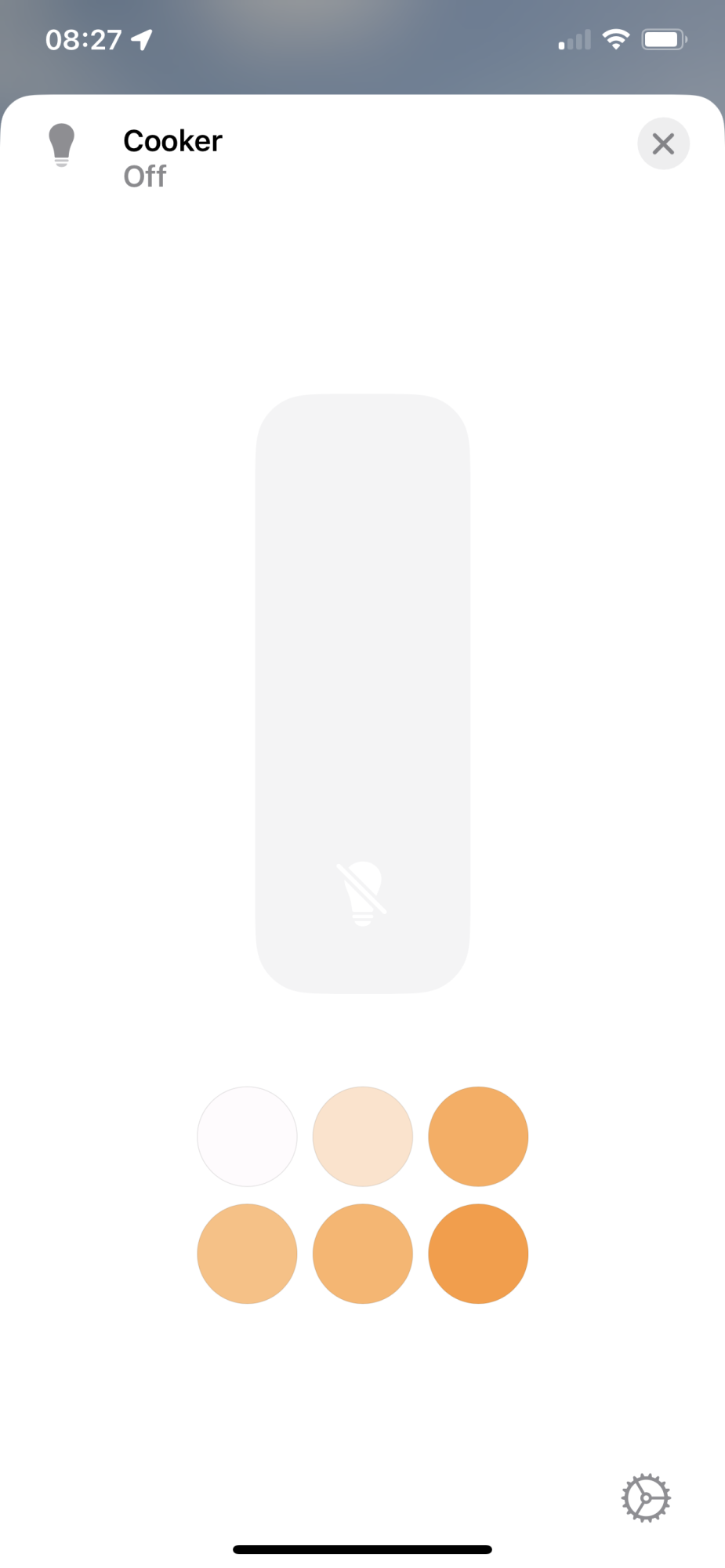

Hi all, my Hue lights used to vary their temperature based on time of day, ending up warm white at the end of the day. Now after the HomeKit update this appears to have vanished. Anyone know how to get this back? Thanks

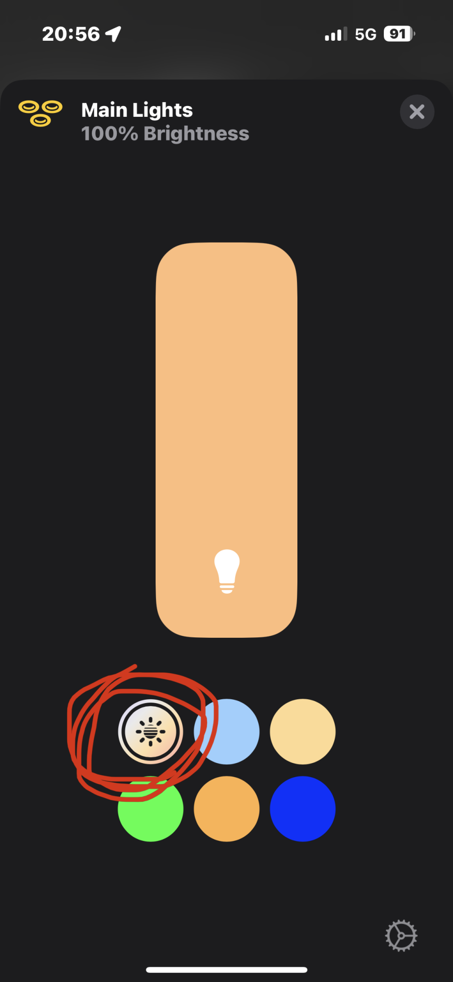

Go into the setting for the light bulb and see if the Adaptive Lighting feature is selected (the circle with the Sun icon in it pictured below). I’ve had it go away in the past but a refresh of the Home app and reboot of the iPhone would bring it back.

It’s from a HomeKit feature called “Adaptive Lighting.” Think it came out in iOS 14 or something like that. Works pretty good and I’m a huge fan of it. In the middle of the day, color temperature changing lights will be bright white but at night or early morning, they would change to warmer white. Supposed to be for circadian health. Few companies offer. Two I know of are Philips Hue and Nanoleaf.
Thanks, I couldn’t remember what the function was called as it was ages ago I set it up. I agree it is a brilliant function.
I have tried quitting the home app and rebooting my iPhone but the symbol is still gone. :(
