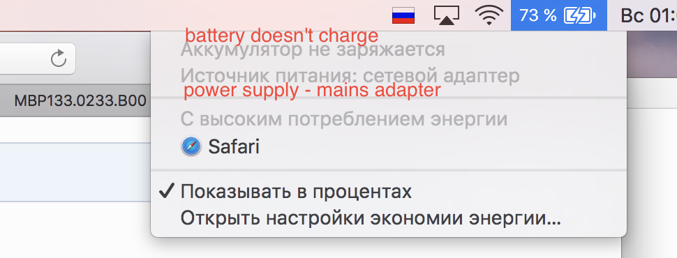

When I plug in the charging cable, the icon changes and shows that the charging is on, but the percentages fall down even when the wire is connected.

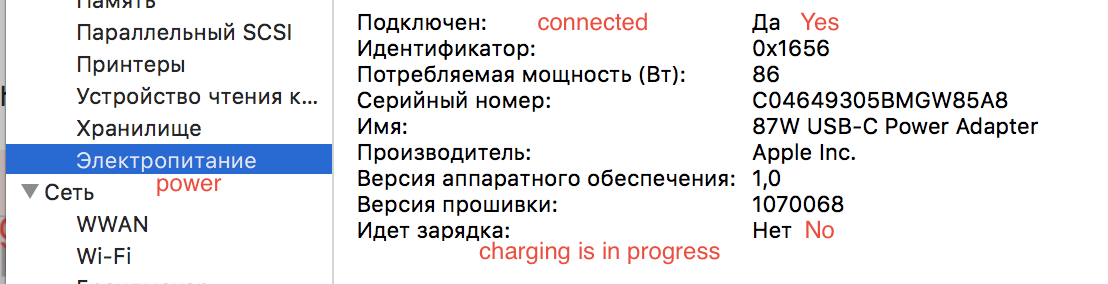

And System Info in "Power"

Everything is in the topic header, screenshots. When the power supply is connected to a power outlet - the charging icon is changing, but not as it should be ...

But ---- you can plug it in right now to your hackintosh, and charging works?
Now, it all makes sense.
There is a partial short on the USB bus (or the charging circuit), on the logic board.
Plug in a power brick, and the USB draws power on the edge of over-current. That would explain why it works for a while.
The over-current eventually causes the internal circuit breaker in the brick to open (so no charging). That MIGHT reset if you unplug the power brick from the wall for 30 minutes or so (or blows out that power brick, with no reset possible)
Will either of your bricks work to charge another Macbook Pro (you could try that at the Apple shop)?
And, the USB port on the motherboard of the hackintosh has different power requirements, and may accept a higher current than the 87-watt brick, just enough to keep THAT hackintosh USB port on line, but causes a power loss on the brick.
You will need to spend some money to fix this, either by repairing the logic board, if you are lucky enough to live near a shop that knows what they are doing with circuit board repairs (considerably less cost to repair than replace the logic board) --- or, have the Apple shop replace the logic board.
