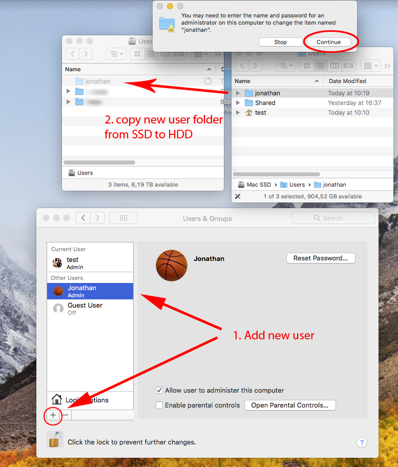

2) So in order to create a new user-account I go to the "Users & groups" system preference, and once that's done I immediately copy that entire user folder over to the hard drive:

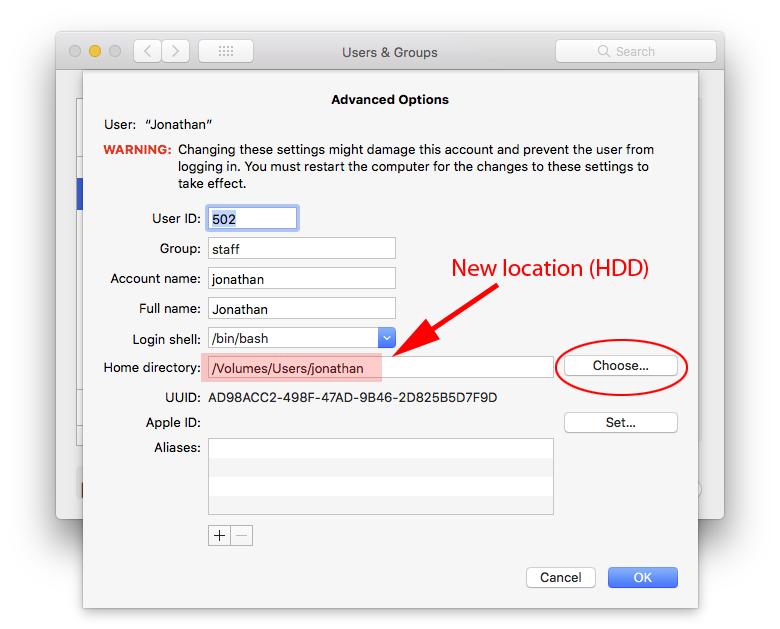

3) Once the new user folder has been copied over I once again go to the "Users & groups" system preference, this time right-click on the new user (Jonathan) which brings up "Advanced options":
4) Now I want to make MacOS see the new user at its new location (on the hard drive), and click the "choose" button, then select the newly copied user folder on my hard drive:

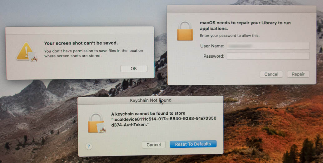

5) Next I log out of my "test" user, and into "Jonathan" where upon the Finder desktop appears I also get a number of error messages (I'm not even able to take a screenshot because of this, so I had to take a photo with my camera):
Obviously something has gone wrong, but what? And how should I do this correctly?
