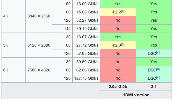

Isnt there some mode, even via HDMI2.0 that gives you 8k? Is it like 8k@30hz maybe with some kind of compression or lowered subsampling? I know DSC doesnt work with HDMI2.0 but maybe there is some lowered settings that get you to at least 8k@30 over the supported HDMI2.0?
Yes, but only if you give up on chroma subsampling 4:4:4. 4:2:0 should be able to do 4k120 at the cost of a worse image quality.
I may be wrong, but I think 4k@120 takes up roughly the same bandwidth as 8k@30.
joevt
Contributor
Jun 21, 2012
6,689
4,085
4:2:0 8bpc is basically 12bpp (4:2:0 is 12 components per 8 pixels which normally has 24 components)
With the bandwidth of HDMI 2.0, that's enough to get 4K120 or 8K30. You just need an OS driver, GPU, and display that will support it.
