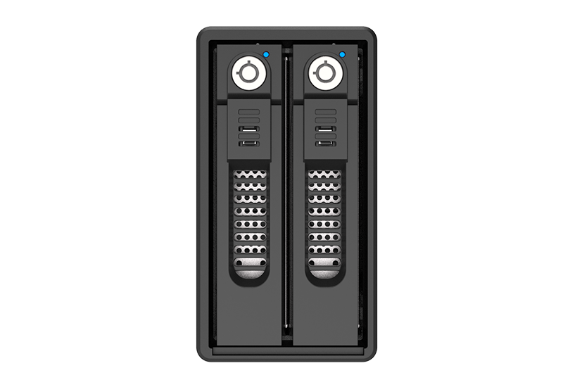

I’m using a Raidon case on my Mac Studio for about 1 month all working without problem
Shortcoming: hot-swappable drives are not really hot swappable, beacause all drives will be shorty ejected when remove or insert a drive.
