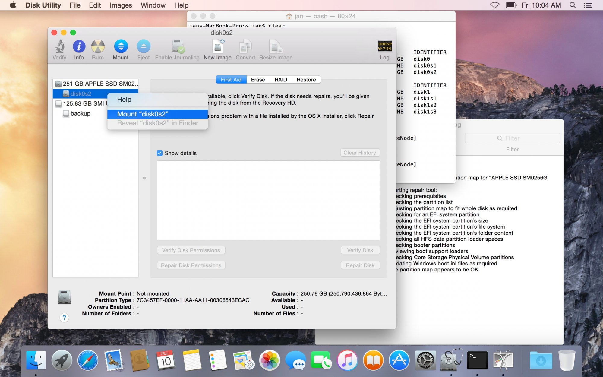

well. long story short, my friend try to update the MAC os (from mojave to Monterey)and get stuck, idk what he did but now his macbook pro 2015(a1502) is able to load into login screen but after login, it start the update bar and it stuck there, we wait it over night and its didnt move one bit,
so now the goal is the get into the macHD and backup all his data and then factory reset.
but i have try everything, and i cant get the macHD mounted and get the data out.
boot to recovery mode try to use terminal mount the HD, (fail)

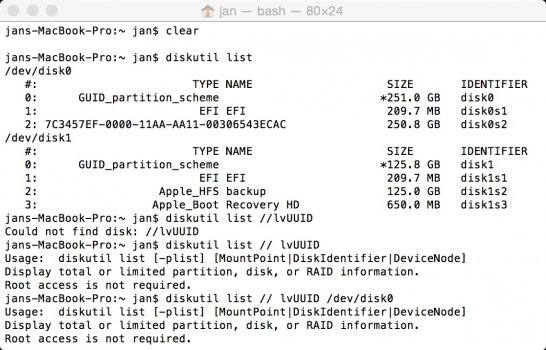

try the "diskutil list // lvUUID" and i cant find the lvUUID
i install the osx yosemite into a usb thumb drive and boot the thumb drive, into yosemite and try to mount the macHD, (fail)
tried "sudo fsck_HFS /dev/disk0s2"(fail)
tried sudo mountDisk readOnly /dev/disk0s2" (fail)
i have try everything that i can find on the net and they all fail.
im run out of idea what can i do next.
any help!??

lameron
macrumors newbie
Dec 9, 2021
2
thank you for replying
i do have the second macbook available, but i do not have the thunderbult cable to connect two macbook, im ordered and its coming this sunday,
as the second option that you mention, i have tried it already, install os yosemite into an EXTERNAL USB and boot from the EXTERNAL USB, i boot all the way up to the desktop but i still cant mount the disk0s2 from Disk Utility, nothing happen when i click mount button the disk0s2.
and i have tried to mount it from the terminal as well, it just wont mount. FML
