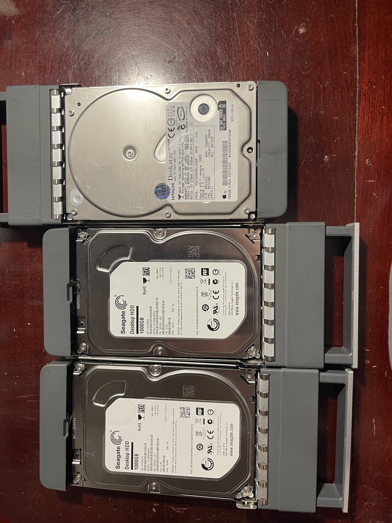

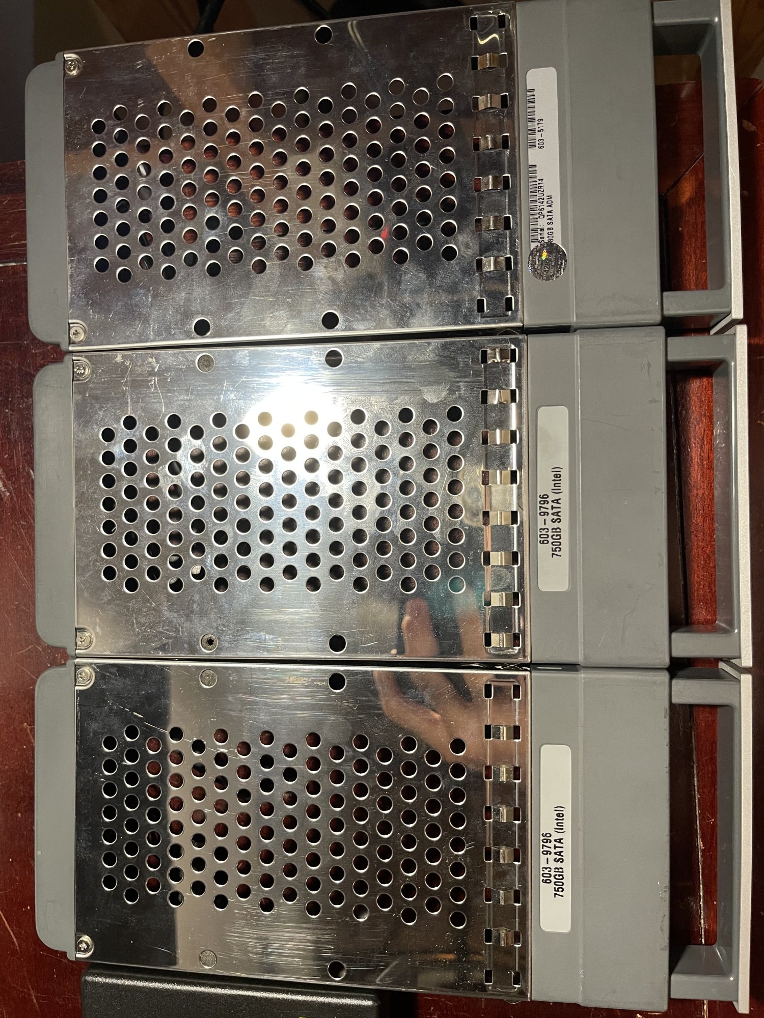

I have included pictures which show all 3 drives and the caddies they are in. The 500GB is in the 80GB caddy and the two 1TB are in the 750GB caddies. I have tried swapping around the drives in the caddies, with the 500GB drive working in all 3 caddies and neither of the 1TB drive working in any caddy.
