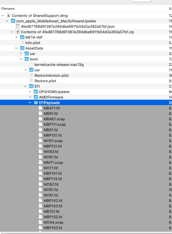

Please let me know if you happen to know how to extract FirmwareUpdate.pkg from recent SharedSupport.dmg
As Catalina is still supported, the last FirmwareUpdate.pkg, coresponding to the Security Update 2022-002 Catalina, should include the latest firmware available.
Code:
https://swcdn.apple.com/content/downloads/17/04/002-65666-A_N12DGDB4NY/w1f2wkeysjf03wnkx0wkjxbdxf2r2oqowv/FirmwareUpdate.pkg
In SharedSupport.dmg for Big Sur and Monterey, look into com_apple_MobileAsset_MacSoftwareUpdate.

Thanks so much for pointing out to Catalina standalone combo update. In fact this article from TEC made me think if it's possible to get FirmwareUpdate.pkg from Catalina's update earlier today (for some reason I didn't get notification of your valuable answer) because it's stated there that Catalina Security Update 2022-001 bumps up firmware version of Macs running Catalina to the same version as Moneterey 12.2 provides. So I downloaded Security Update 2022-001 Catalina (SecUpd2022-001Catalina.dmg) and indeed found FirmwareUpdate.pkg there! PKG contains required Scripts folder as mentioned in Duo-Labs-The-Apple-of-Your-EFI.pdf and Github Gist you've linked above.
However thanks so much for taking time to get the link from Apple's catalog! The [TOC].xml inside standalone FirmwareUpdate.pkg file via your link says that package was built on February 5th, 2022 when according to TEC article the Security Update 2022-002 Catalina update was released on January 26th, 2022. The file size difference isn't huge but it made me unsure. I then verified your link with Catalina's update catalog. Looks it's all good, just SecUpd2022-002Catalina.dmg is not here yet (SecUpd2022-002Catalina.smd is in catalog with all contents).
Since my 2020 16-inch MacBook Pro (the one updated with AMD Radeon Pro 5600M) came with Big Sur preinstalled and was actually released June, 15th, 2020 which is before macOS Big Sur release on November, 12th, 2020, I think FirmwareUpdate.pkg from SecUpd2022-002Catalina.smd via your link will do the job. I'd be really happy to know if you think it's a good idea to do it since I didn't do standalone firmware update before.
As it goes to EFIPayloads folder, I've found it myself previously, but this very folder doesn't contain firmwares for Mac with T2 security chips, one of which I happen to own. Firmware versions that are contained in that folder and Mac models corresponding to files were posted in this TEC article (data fetched by Pico and posted in different article's comments on TEC). I'm not sure if BridgeOS update (it's somewhere in SharedSupport.dmg) contains EFI firmware and uses /usr/libexec/efiupdater so I won't try it on my own for sure.
