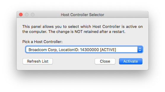

Well, I want to share an alternative solution that works without standing Mac mini on its back or messing with cables or USB ports. This is also an update to my previous effort described to Aug 23, 2019 in this thread.
All you need is a $20 Bluetooth USB dongle. It has to be use chip that has built-in driver in macOS. I use StarTech USBBT1EDR4 dongle based on CSR8510 A10 chip that is supported out of the box. In general any USB dongle using CSR8510 should work for you. If you find other dongle working too, please share. NOTE: The device must be proper USB dongle, not UART via USB (see below why).
Once you got the dongle, it is easy to plug it in. But the tricky part is to TURN OFF existing broken built-in Bluetooth permanently so it remains off after reboot. After few attempts using private APIs, numerous reboots and studying assembly of Apple's Bluetooth drivers I finally found undocumented NVRAM setting. :D Here it is:
sudo nvram SkipIOBluetoothHostControllerUARTTransport=%01
It prevents UART transport based driver from probing the devices, which effectively disables built-in Mac mini Bluetooth that uses UART interface, but leaving USB transport enabled - which makes our USB dongle only one dongle in the system, thus default active one.
If this works for you too, please let me know. Now finally I can enjoy stutter free, butter smooth mouse action for extra $20. I hope you can too.

Just installed this:
Used the (7.3) hardware tools / BT explorer just to do a temp change from the internal BT to this, will eventually do the NVRAM if this is a good, perm fix. :)
Side note: I still want a MM 2 in black/space gray :D

According to their website they say "Apple does not fully support the 4.0 Bluetooth Chip set used by the GBU521."
There are no drivers. How are you using this?
It has a compatible Broadcom chip, I believe that documentation is about some BT 4.0 features, but it's fully backwards compatible:
FWIW, I have not had a single mouse issue since installing this ...
