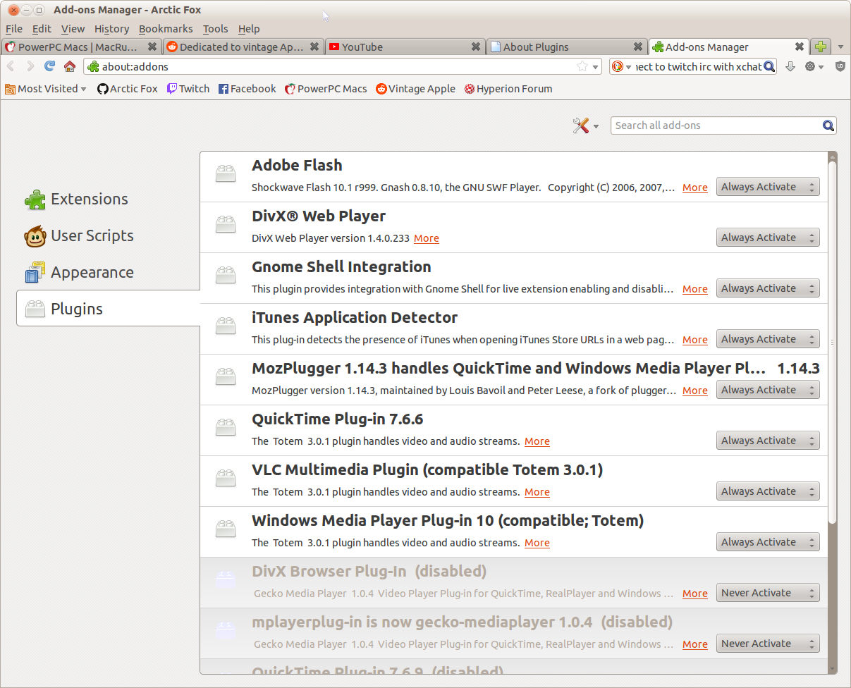

Pretty good. If you install totem and all the gstreamer plugins, they work great with mozplugger for in browser playback. VLC and mplayer still handled all i tossed at them. I did also build the latest ffmpeg (and bash 5.0) on 12.04 and included them in the remix as i use youtube-dl (also included) with ffmpeg piped to vlc to watch Twitch streams.

I'll have to play around a bit, as I cannot get any in-browser video to work, even after installing all of the plugins. I'd normally just build youtube-dl-gui, so I'll give that a try.
EDIT: Turns out that there's a version of youtube-dl-gui built for Precise, so I gave that a try. It installed fine, so I installed x264, set the video resolution to download to 640x360, and copy/pasted a YouTube video to download. It downloaded the latest youtube-dl and downloaded the video fine. VLC plays it fine; Totem can't find the h.264 plugin. Higher resolutions play horribly, so 640x360 (360p I assume) is it.

Try installing grease monkey and get the viewtube script (browser-plugin-vlc is already installed). Then in viewtube prefs set it to use vlc or totem. Both work well for me. Make sure you enable the plugins in the browser too. AF by default disables plugins. Optionally install mozplugger also to make use of the gstreamer/totem plugins.

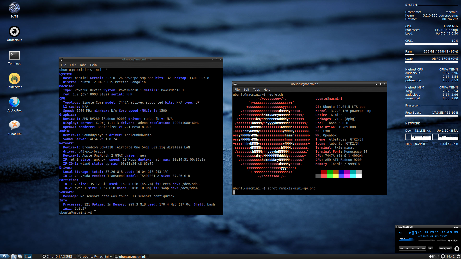

Here's my current remix12 desktop on my macmini g4:
Cheers

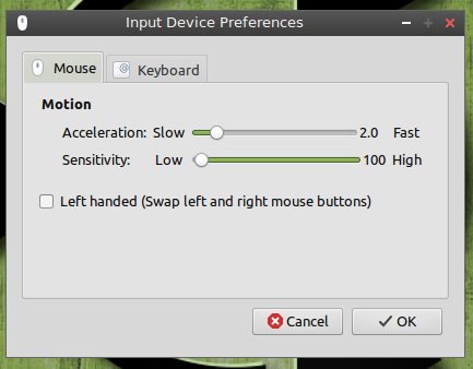

I just tried Lubuntu 12.04 on my PB 5,8:
- CPU scaling governor NOT working flawlessly: „ondemand governor failed, too long transition latency of HW, fallback to performance governor“ - CPU always runs in PERFORMANCE mode, POWERSAFE manually possible.
- incredible!!!!! - SLEEP is working, closing the lid is working!
- touchpad feels ugly. I cannot find the alterations someone recommended to smothen the feeling of the trackpad. Any help?!

@saxfun : Glad to know sleep works. I oddly never tested it. For trackpad i just adjusted them to less sensitive levels and it's better. Not as good as osx, but better. Menu -> prefs -> keyboard and mouse. Here's my setting on my powerbook running 16.04.
